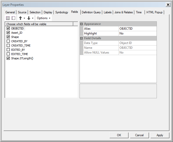

For years I have been using ArcMap to successfully publish map services to our gisserver, and as a large portion of my map layers have database tracking applied, as database time and not UTC, I have come to learn I need to uncheck the editor tracking fields prior to publishing a web map, in order for it to successfully publish.
This above technique worked no worries. It would stop ArcMap from complaining about timezone issues.

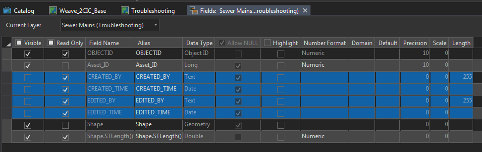

My initial thought was that I just need to try to find the feature layer and uncheck the editor tracking fields, so this is what I come up with:
This has had no luck as I am still getting the aforementioned error.
