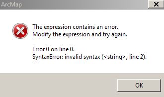

This is what I'm exactly looking for! To stack multiple attribute fields into one label. In Label Expression, I attempted to copy and paste this code into my expression dialogue window. With my code looking like:
def FindLabel ( [CV_Ranches_Table_ArcGIS.txt.First], [CV_Ranches_Table_ArcGIS.txt.Second] 😞
  return [CV_Ranches_Table_ArcGIS.txt.First] [CV_Ranches_Table_ArcGIS.txt.Second]
"Name: " + [CV_Ranches_Table_ArcGIS.txt.First] + '\n' + [CV_Ranches_Table_ArcGIS.txt.Second]
After selecting the first and second attribute fields, it automatically added the "def FindLabel" code so I kept it thinking this was standard beginning for all codes...
But I receive an error message each time.

It's hard to tell exactly what your final code block was (not sure if you had the important keyword 'return' in there), but this should work:
def FindLabel ( [CV_Ranches_Table_ArcGIS.txt.First], [CV_Ranches_Table_ArcGIS.txt.Second] ):
  return "Name: " + [CV_Ranches_Table_ArcGIS.txt.First] + '\n' + [CV_Ranches_Table_ArcGIS.txt.Second]
At least, that type of syntax works for simple field names, not sure about field names with '.' (honestly, I didn't know that was possible).
MaeganSalinas
Deactivated User
Awesome! It worked. Thank you so much, Darren
