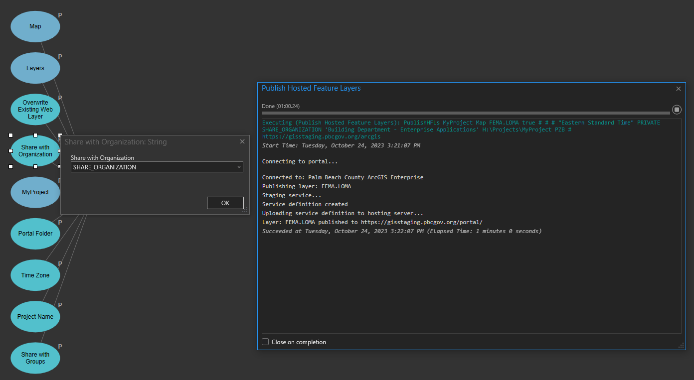

This image shows my script successfully ran and I was signed into portal, and my sharing parameter was correctly set to SHARE_ORGANIZATION:
the actual script collects the parameter as input in a variable called share_organization (which can be set to SHARE_ORGANIZATION or NO_SHARE_ORGANIZATION per the ESRI documentation).

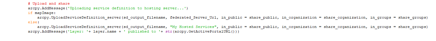

The upload command is here (uses the else clause in this particular case):

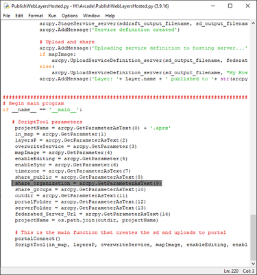

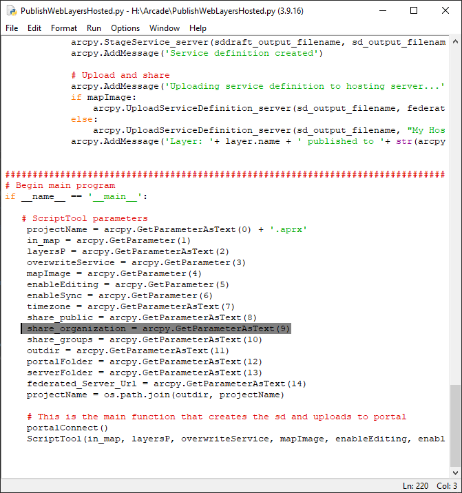

Parameters collected here:
