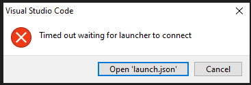

While debugging I get this error, not sure what is causing this..

Nice, and you'll have to create a debugging file for debugging.  This article has a good step by step that you can follow to create one: debug-python-in-vscode   Just the part for creating the launch.json file.
