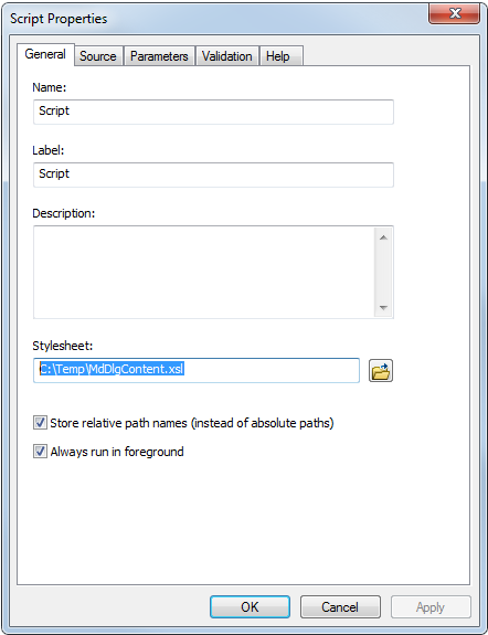

This isn't possible in python, but you can by using a custom stylesheet.
  1. Copy "C:\Program Files (x86)\ArcGIS\Desktop10.2\ArcToolbox\Stylesheets\MdDlgContent.xsl" to the same folder as your script.
  2. Edit line 467 to remove STYLE="display:'none';", i.e. change:
    <DIV ID="{PropertyGroupName}" STYLE="display:'none';" onclick="window.event.cancelBubble = true;">
    to
    <DIV ID="{PropertyGroupName}" onclick="window.event.cancelBubble = true;">
  3. Then in your script tool properties, set the stylesheet property to your edited.xsl.
