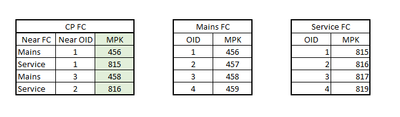

Hi, I am new to arcpy and trying to automate one of my daily task.
i want to use Searchcursor Inside UpdateCursor for multiple fc look through. I want to update MPK field form CP fc based on Mains and Service fc. please help.
