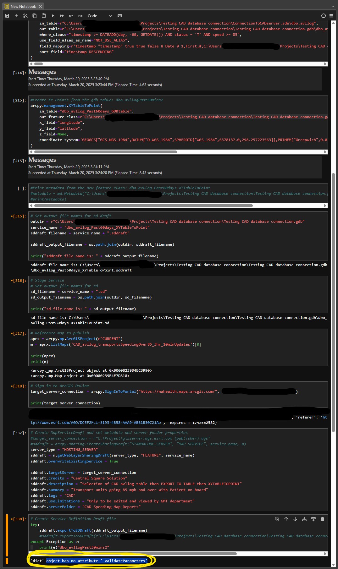

I am trying to write a Notebook/Python script that will:
  1. select certain records from an SQL Server
  2. then export to a File GDB Table
  3. then I run the XY Table To Point tool to create a Feature Class from the File GDB Table
  4. then complete an Overwrite Web Layer, which is in our ArcGIS Online account
I was able to publish the original web layer and also overwrite it manually via mouse and keyboard in ArcGIS Pro.
My script will complete steps 1-3, but at step 4 I am getting this error:
'dict' object has no attribute '_validateParameters'
Libraries and Modules I have uploaded:
Error can also be seen at the bottom of this screenshot (screenshot is also attached, incase this one is showing up too blurry) of my Notebook:

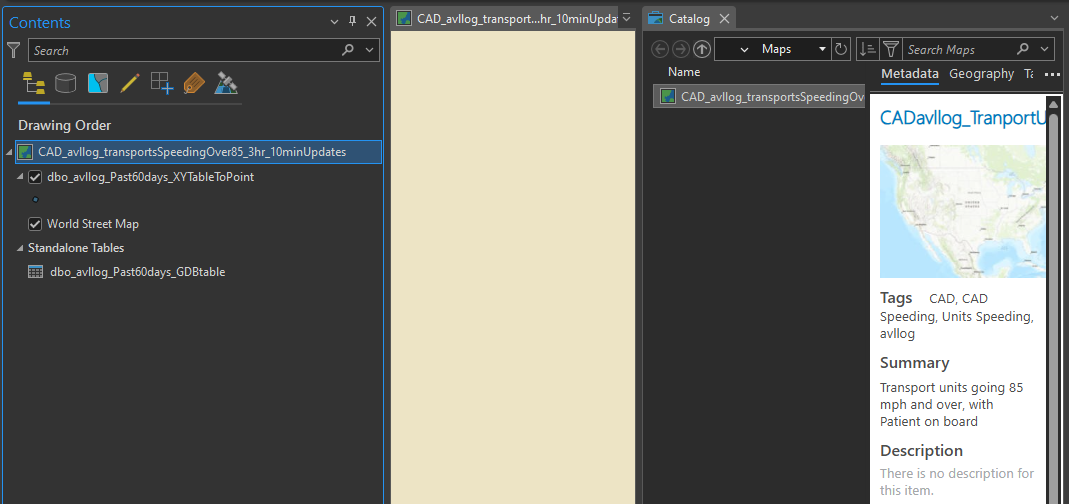

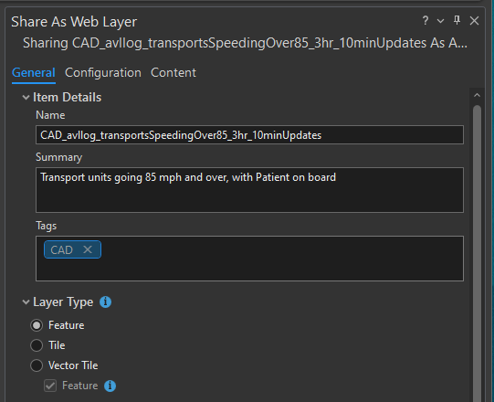

I have filled in the Name, Summary, and Tags (required items in order to publish or overwrite a web layer) for my map:
When I complete steps 1-3 above in my Notebook, those required items stay in place for the Map:

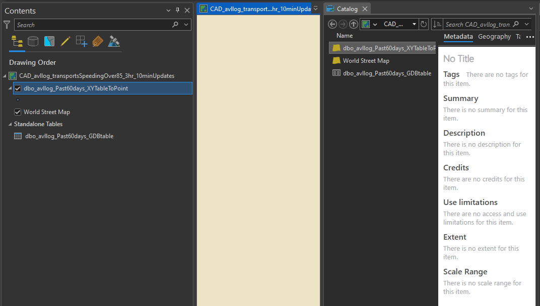

However, when I complete steps 1-3, the required items in the Feature Class will disappear, not sure if I need those required items in the Feature Class when I do a Share > Publish Web Layer / Overwrite Web Layer:

Hi @eallan,
It looks like you are placing the sddraft_output_filename and your sd_output_filename in your file geodatabase. It more than likely doesn't like the '.' (dot)
Set these to another folder that is not a .gdb
After that, if not working, test commenting out sddraft.serverFolder (or replace for sddraft.portalFolder)

That was the fix @Clubdebambos ! Thank you so much for helping me find the issue and correction for it. I ended up figuring this out yesterday after I spent a couple hours going through my code (ahhhh!) when I should of just checked back here and looked at your response ha.
