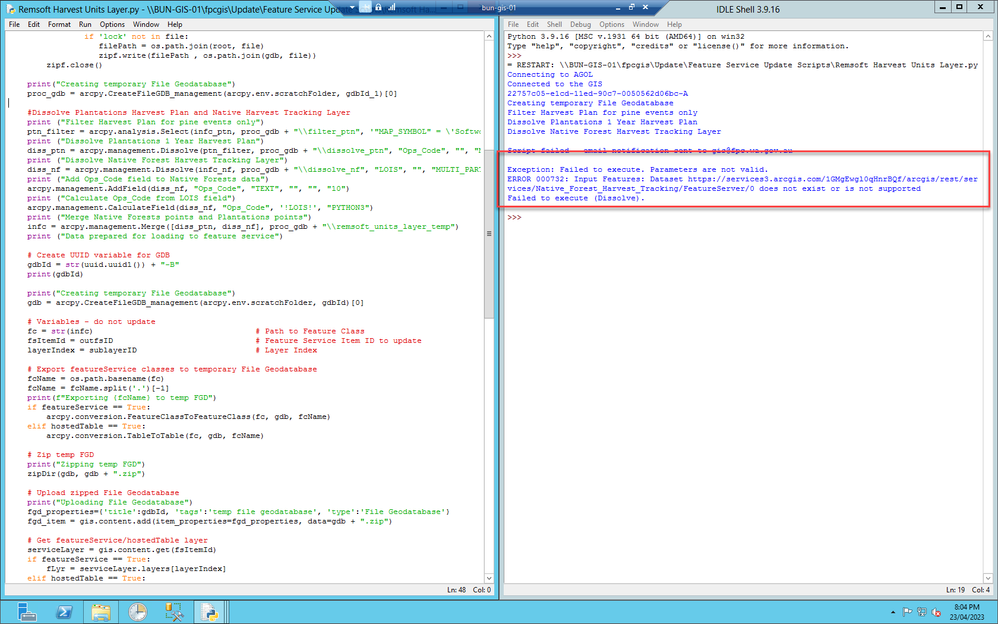

I have a python script that takes an ArcGIS Online feature service and uses it as an input in an arcpy Dissolve process. I built it (and ran it successfully) on my PC which was running ArcGIS Pro 3.1 but found it wouldn't work on our server which was still running 2.9.5. I put this down to advancements in the capabilities at the 3.0 upgrade and relevant python packages.
However, we recently upgraded our server to 3.1 as well and when I tried running this script on there, it fails complaining about the parameters (fails at the step where it tries to dissolve a feature service). Why would this be when all the software is supposedly the same?

I'm having the exact same issue with the same version of python. Server 11.1 script gives error
Error Info:
Failed to execute. Parameters are not valid.
ERROR 000732: Input Table: Dataset A:\ArcGIS\DixTools\Connections\CamaVision64.odc\GENERAL does not exist or is not supported
Very same same script on Pro desktop machine successfully runs. Running from IDLE Python 3.9.16 [MSC v.1931 64 bit (AMD64)] on win32 I am connected to the server via remote desktop?
