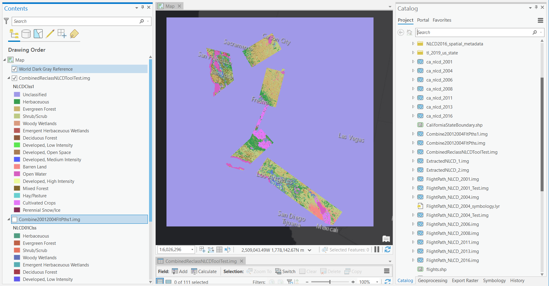

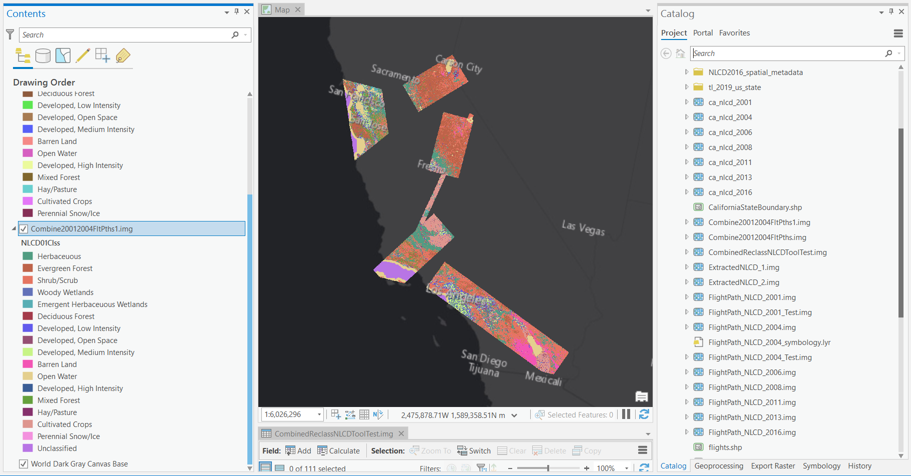

Hello everyone. I am fairly new to creating ArcGIS Pro scripts tools. This is the second script tool I have made. I created a script tool I named "Land Cover Change Type Tool" in ArcGIS Pro 2.5.0 that will take input two different years of NLCD data, then Extract By Mask the rasters using a user shapefile input, then run the Combine tool and add some new fields and using Field Calculator, populate the new fields. When I run my stand alone script with IDLE, I get the exact results I want, which in ArcGIS Pro looks like this:

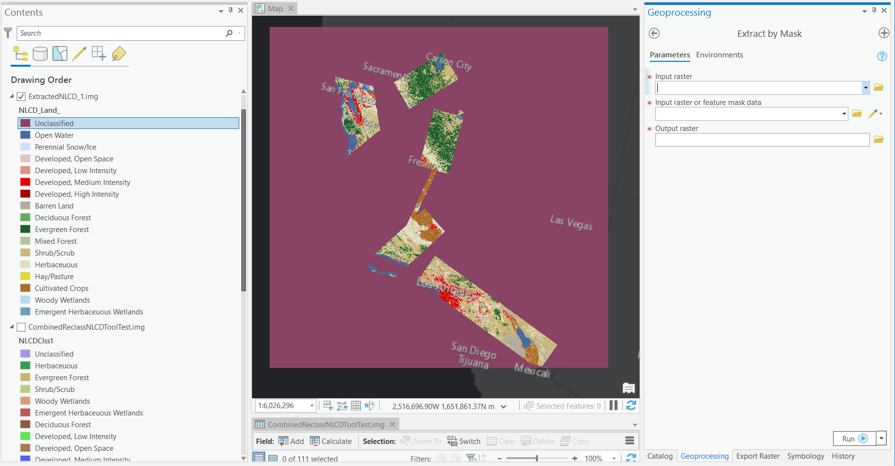

However, in my script tool "Land Cover Change Type Tool", everything pretty much runs right but I get a large rectangular box with unwanted "Unclassified" data/pixels in the product, as you can see here:
It looks like my two Extract By Mask rasters products also have the bounding rectangle in them:
However, when I look up the Extract By Mask tool on ArcGIS Pro's Tool Reference website, there is no information in the syntax about enabling or disabling a bounding rectangle option.
Would anyone know what might be possibly causing this change/issue I am having with the unwanted rectangular box of unclassified pixels showing up in my script tool. Here is my script for the script tool:
