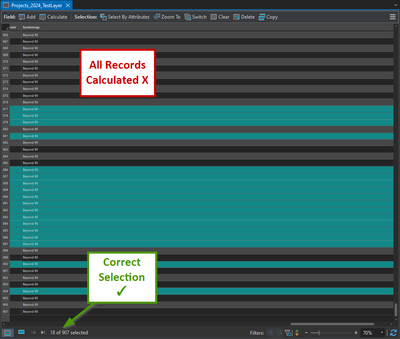

I am trying to create a Script Tool that will 1)  select records in my feature layer based on a date range in a date field (date only), and then 2) calculate a field for those selected records ONLY to a desired string that the layer's symbology is based off of.

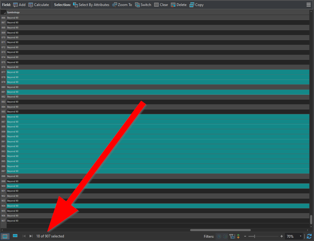

This is the result of my Script Tool right now. It has the records selected accurately based on my date range, but calculates the entire layer's Symbology field to "Beyond 90" when I need it to only calculate the selected records.
If I perform this process manually, the calculate field tool will use the 18 selected records and update those 18 selected records' fields only.

@BlakeTerhune Thank you for this information. I may have this messed up in one of the ways you mentioned... I do have a parameter (the only parameter) for the Project_Layer, and it is chosen at run time.  However, I do select the layer from the script tool's drop down list of layers in the current map. Also, the only layer I have in the map is the one project layer, so I can rule out any confusion there.
I might need to add some validation like you have suggested, but I am certain that the records get selected. Referring to my original screenshot - once the tool is ran I can see that the records I want to select are accurately and successfully selected. And this selection step executes prior to the final field calculation in the script... So, I'm still a bit confused/lost but I know there has to be something I'm missing.

MichaelBowers
I tried what you suggested but unfortunately got the same result. The tool ran successfully but all records were calculated again.
