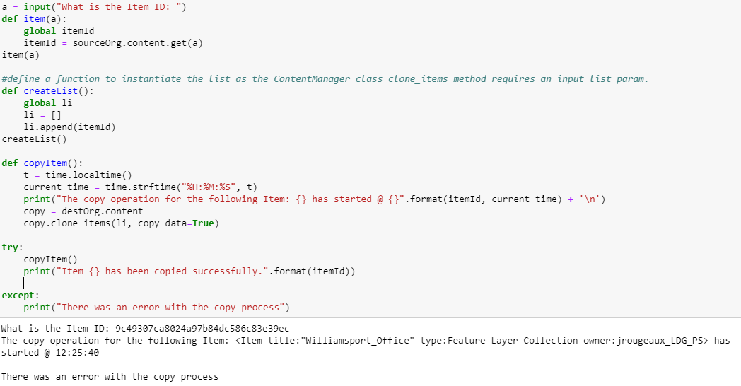

I have a Python script that is designed to take feature layers from ArcGIS Online and move them to Portal.  All the inputs work fine until the last part where it attempts the copy.  Here's a screen snip of the script and the output.  The script is correctly identifying the feature to copy but then prints there was an error.  I'm having trouble determining what is causing the feature not to copy.
Any help or advice is much appreciated!

I've been told by ESRI tech support that AGOL is 2 versions ahead of Portal.  Would this make a workflow of copying data from AGOL to Portal not possible, although copying data from Portal to AGOL would work?
JacobRougeaux
I reversed the workflow and told it to copy from Portal to AGOL.  That worked.  So it appears the versions being different and trying to copy from old (Portal) to new (AGOL) could be the source of the problem?

why not have the functions that you create called within your try-except block, or check within your print statement that "li" actually has any values.  only itemId is checked

Dan, thanks for the suggestion.  I had it print "li" and confirmed that it contains the appropriate value.
