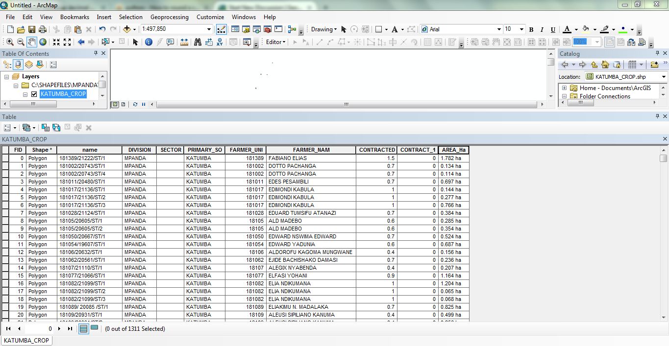

I want to use the Field Calculator in ArcMap to round an existing column to two decimals. Currently I have a column (AREA_Ha) that is 3 decimal places long and would like to simply round it down to 2 decimals.

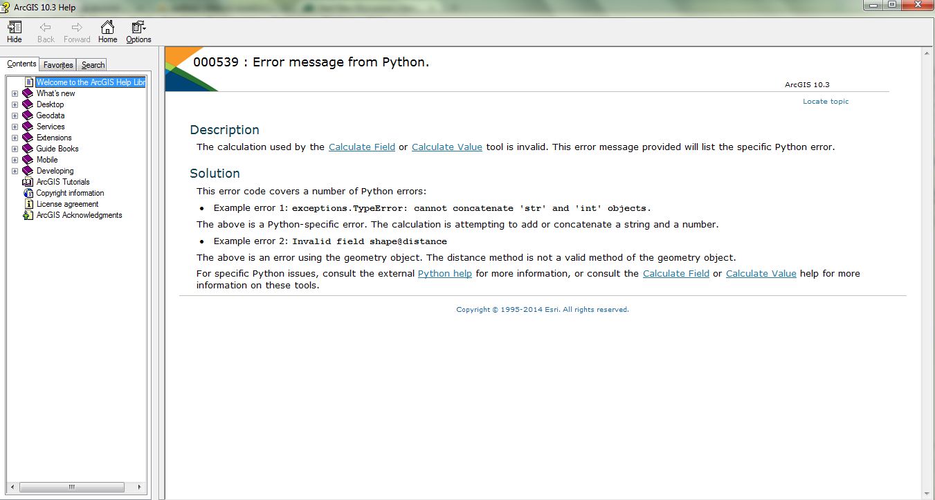

I have tried this ( round(!AREA_Ha!, 2)) but get this error message " There was a failure during processing, check the Geoprocessing Results window for details.
Your help please.

that is because your area field was made into a string.
You can tell because it is left justified and contains 'ha' at the end. So however you created the area field wasn't a true area field but the representation of an area field.
The most descriptive is to follow
a = '1.2345 ha'
round(float(a.split(" ")[0]),2)
yields 1.23
where 'a' is your field name
