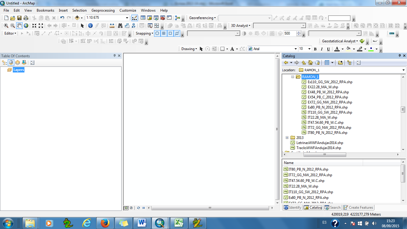

I have a list of SHP files that I want to rename. First, I want to replace the "." from the shp to "_", and then rename the file. As you can see in the image below:

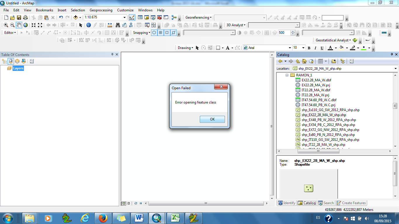

The problem is that when I am trying to open the SHP file it does not work. I am getting the following error message:

Looking at the results, its literally only changing the name of the .shp files, and not some of the other file components that comprise a working shapefile.  Notice your dbf file and prj file are still the old file name when shown in catalog.  You could do a arcpy listfiles with wildcards for those file endings and change the names similar to what you did for the .shp files.  I would also check the other elements of your shapefile in windows (.shx, .sbx, .sbn, etc.) and make sure they are properly renamed as well.

Your stripping the file extensions off of the files, so ArcGIS Desktop won't see them anymore as shapefiles because the files don't have the proper file extensions.
Although I am a big fan of using native Python tools instead of ArcPy tools, sometimes the ArcPy tools work best.  In this case, I recommend using the Rename tool because it will take care of renaming all the associated/related shapefile files along with the SHP file.
