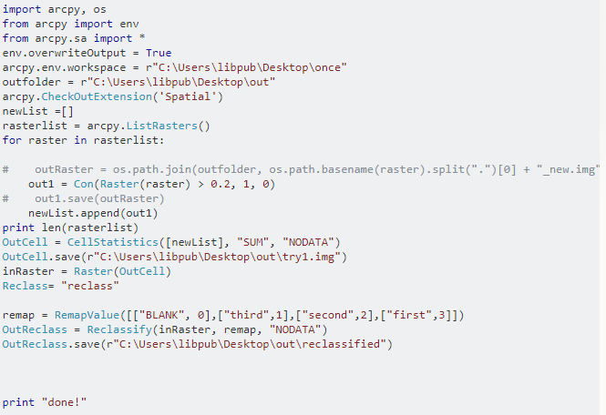

Rumba1Nma
Dear Dan,
Thanks for the response, I modified my code a bit, but still getting
errors.It runs fine untill line 18 because it print 4, which is my number
of raster in the input.
How do I proceed further? And once I reclassify, what tool can I use to
overlay reclassified on NDVI raster to display the relation?I am attaching
the snap of
code and errors.Thanks much
DanPatterson_Retired
MVP Emeritus
Use code formatting rather than screen grabs in case someone wants to replicate the code.
From Cell Statistics I don't think it is getting a list of rasters... examine the code example,  putting something into a list doesn't make it an object, make sure that the raster actually lists, it should be added to the list using the raster layer name or the source raster from disk
Rumba1Nma
Thank you Dan, makes sense.
