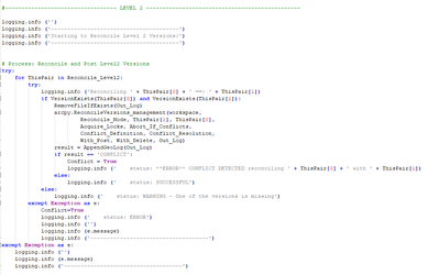

Could you share the code that you are using? I'm curious if the conflict_definition and conflict_resolution parameters are set?
BrettRosso
Hi Jeff,
Here's a screenshot. What we're trying to figure out is why exactly certain versions and the folks that are using the versions are getting this particular error. It has come up out of the blue and hasn't been an issue before but only the geoprocessing log is giving us this info that 'The item does not have a definition'
