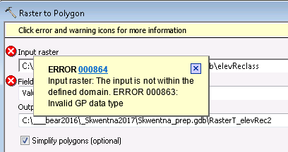

So, now the issue is that the RasterToPolygon does not see the outDEMtmp as a valid raster,
even though it appears to be fine when displaying and/or looking at the properties.
the error in the python window (which I tried first)
>>> arcpy.RasterToPolygon_conversion(outDEMtmp, pElevClass, "SIMPLIFY", "Value")
Runtime error  Traceback (most recent call last):   File "<string>", line 1, in <module>   File "c:\program files (x86)\arcgis\desktop10.3\arcpy\arcpy\conversion.py", line 337, in RasterToPolygon     raise e ExecuteError: ERROR 000864: Input raster: The input is not within the defined domain. ERROR 000367: Invalid GP data type
Neither of the error seems to be relevant. A restart didn't help....so on to researching this.     ...maybe I'll copy to a new raster, if that works.  Any chance the NumPyToRaster doesn't work quite right??

I've found a few discussions and KB on the "raster not within domain" and I'm working on trying to get some of those to work. I even exported the raster to an .img with no luck.
Some of the threads i'm looking at:
There are others that I am still looking at.  My output values are integer values 0, 9, 2000, 6000 so I'm not sure how to apply the raster calculation suggestion.
Dan, are you still testing with Pro and python 3.4?  Again, I'm trying to stick to Desktop and standard install....government budgets and all.  Although I may have all the bells and whistles available to me, those I give this to may not.
RebeccaStrauch__GISP
MVP Emeritus
RasterToPolygon gives the same error, even if I do not define the projection first.

The data type of the array must be integer, I think you still have floating point values, so here is a sample, converting one of my random integer .npy files into an integer, an image, then a polygon
>>> az
array([[  0.,  0.,  6., ...,  0.,  0.,  4.],
      [  0.,  0.,  0., ...,  0.,  2.,  0.],
      [  0.,  4.,  0., ...,  10.,  0.,  0.],
      [  2.,  0.,  0., ...,  0.,  0.,  2.],
      [  0.,  0.,  0., ...,  0.,  8.,  0.],
      [ 10.,  4.,  0., ...,  0.,  0.,  6.]])
>>> eee_zee = az.astype(int)
>>> eee_zee
array([[ 0,  0,  6, ...,  0,  0,  4],
      [ 0,  0,  0, ...,  0,  2,  0],
      [ 0,  4,  0, ..., 10,  0,  0],
      [ 2,  0,  0, ...,  0,  0,  2],
      [ 0,  0,  0, ...,  0,  8,  0],
      [10,  4,  0, ...,  0,  0,  6]])
>>> out = arcpy.NumPyArrayToRaster(eee_zee)
>>> out.save("f:/temp/ez.tif")
>>> p = arcpy.RasterToPolygon_conversion("f:/temp/ez.tif","f:/temp/ez_.shp","NO_SIMPLIFY")
Now, you have to be aware that it will make many unique areas IF you have many areas. That could be limitation
I just used the no_simplify and sent it out to a shapefile which loaded into arcmap
The keep line is eee_zee = az.astype(int)  ... that sent the floating point array to an integer view.  Then I saved it to a raster (tif) then to a shapefile
