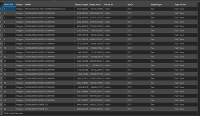

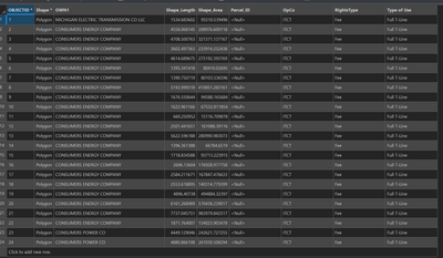

@BlakeTerhune
So, I run the code from my initial question that (thanks to your suggestion) is running wonderfully, here's a sample:
cur = arcpy.UpdateCursor(fc)
for row in cur:
    if row.getValue('OWN1') == 'ITC' or 'TRANSMISSION':
        fieldname = 'OpCo'
        field = arcpy.ListFields(fc, fieldname)[0]
        for domain in domains:
            if domain.name == field.domain:
                coded_values = domain.codedValues
                lookup_values = dict(zip(coded_values.values(),coded_values.keys()))
                break
 # Set 'OpCo' field
        with arcpy.da.UpdateCursor(fc, fieldname) as cursor:
            for row in cursor:
                row[0] = lookup_values['ITCT']
                cursor.updateRow(row)
But, then I run the next portion:
for row in cur:
    if row.getValue('OWN1') == 'CONSUMERS':
        fieldname = 'OpCo'
                break
 # Set 'OpCo' field
            for row in cursor:
                row[0] = lookup_values['METC']
It spits out:
the OpCo field should all contain "METC"
In theory, if OWN1 contains CONSUMERS, OpCo should be"METC"
and if OWN1 contains ITC or TRANSMISSION, OpCo should be"ITCT"

danieloccasionally
I apologize for my terrible explanations, @BlakeTerhune!
My initial question was how to read one field and then apply a domain value to another field with UpdateCursor. (To be honest I had written successful code for this ... then accidentally changed something.) You helped immensely, which I very much appreciate!
After I applied your suggestion, I then attempted to update the code to search the OWN1 field for "ITC", and "TRANSMISSION, TAX DEPARTMENT", or "CONSUMERS.
It was supposed to search the OWN1 field:
If it found "ITC", or "TRANSMISSION, TAX DEPARTMENT", it would change the OpCo field to "ITCT".
If it found "CONSUMERS", it would change the OpCo field to "METC".
Instead, the code wrote only "ITCT" or "METC" in the OpCo field depending on which I ran first. I'm sure it's obvious that I'm new to coding (but unfortunately, I kind of love it), and cannot see what's wrong.
Hopefully, that makes sense! No matter what, thank you for your time.
