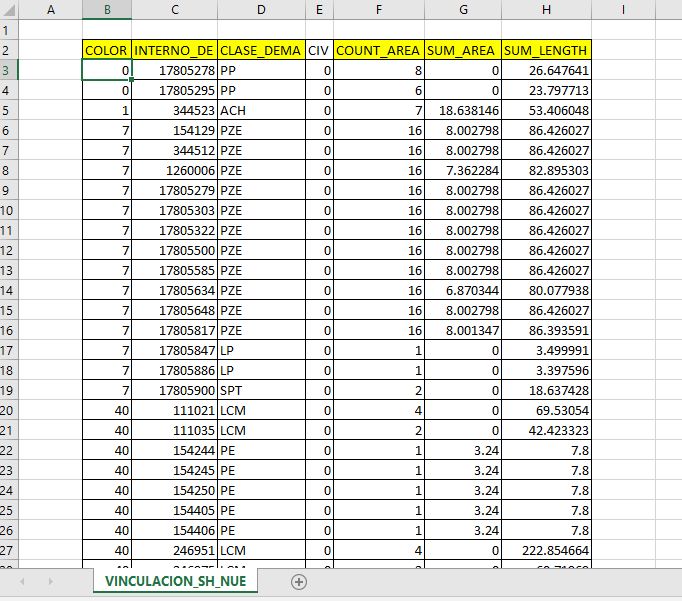

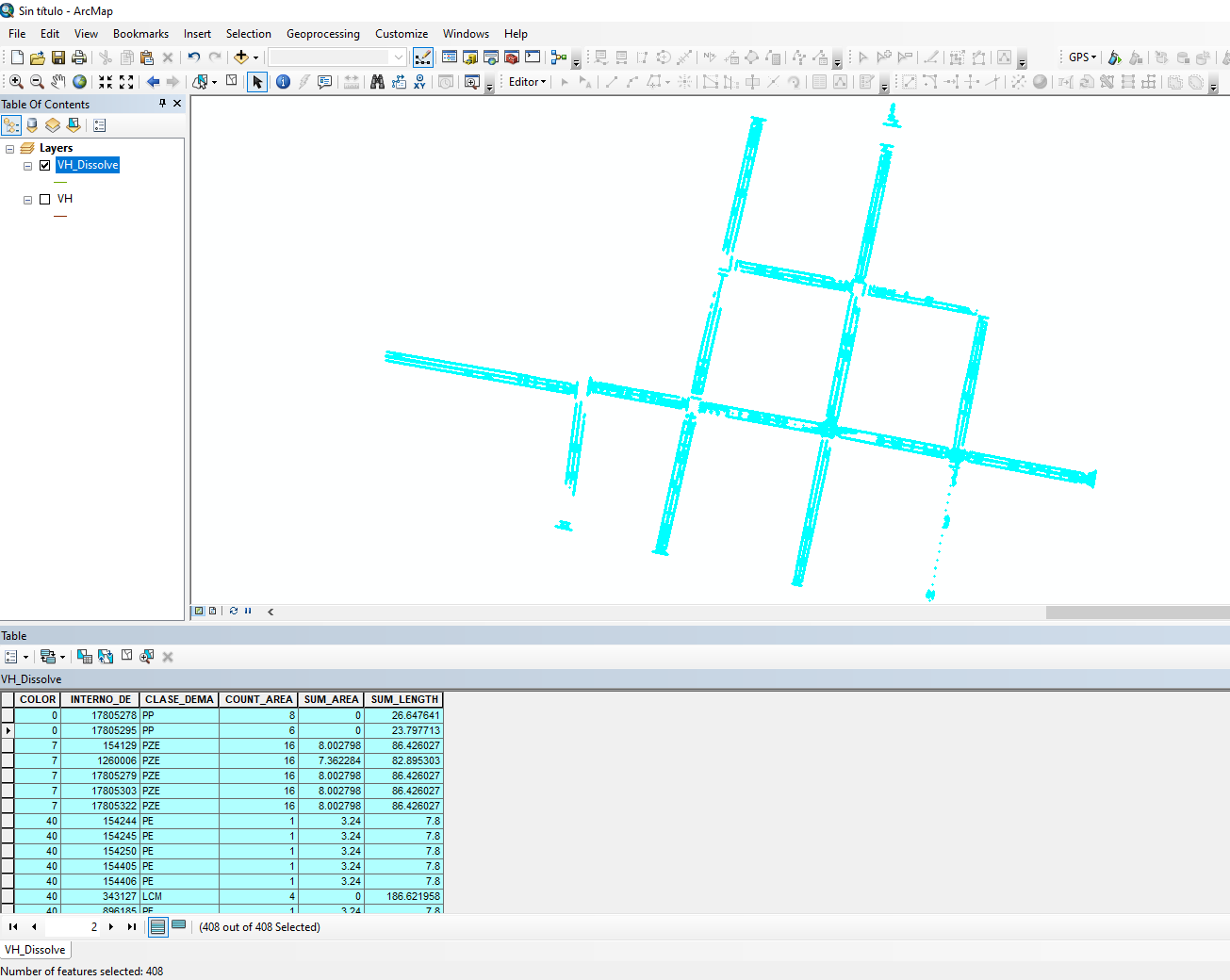

I would like to know if there is any way through Python to query the fields of an attribute table of a .shp file (ArcMap) from an .xlsm file (Excel with macros enabled), this since what I currently do repetitively and manual is to copy the attribute table from ArcMap to my Excel file "VINCULACION_S.xlsm".
One of the attribute tables that I want to copy is the one I show in this image,
JosephBriamRamonRodriguez_1-1622745004422.pngJosephBriamRamonRodriguez_1-1622745004422.png
Towards the .xlsm file already mentioned, which I show in this image.
JosephBriamRamonRodriguez_0-1622744959302.pngJosephBriamRamonRodriguez_0-1622744959302.png

What I want to do is query the fields of a .shp file from an excel .xlsm file, that is, avoid the repetitive and manual process of copying the attribute table from arcmap to the working .xlsm file,
For example, query and write the values ​​of this attribute table displayed in arcmap and contained in the VHDissolve353.shp file from my Excel VINCULACION.xlsm file
Screenshot 2021-06-03 110625.pngScreenshot 2021-06-03 110625.pngScreenshot 2021-06-03 110738.pngScreenshot 2021-06-03 110738.png
Note: The attribute table and the table in excel have the same fields.
