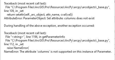

However, when I try on value tables, I get the following error.
 param2 = arcpy.Parameter(displayName='Input Data',
                                 name='InputData',
                                 datatype="GPValueTable",
                                 parameterType='Required',
                                 direction='Input')
        dTypes = ["DEFeatureClass", "DEFeatureDataset", "DETable",
                  "DEMosaicDataset", "DERasterDataset"]
        param2.columns = [[dTypes, "Old"], [dTypes, "New"]]
Hmm, ok. Maybe I'm just doing it wrong? Let me try making it a single parameter type
                                 name='InputData',
                                 direction='Input')
        param2.columns = [["DEFeatureClass", "Old"], ["DEFeatureClass", "New"]]
Bingo:
So, my question is: How can I make a value table parameter accept multiple data types?
(Also, before anyone suggests it, I did already try
param2.columns = [[["DEFeatureClass", "DETable"], "Old"],
                   ["DEFeatureClass", "DETable"], "New"]
 with the same results.
HaydenWelch
MVP Regular Contributor
I would do the type checking in the validation function instead of the initialization. You can just pass "GPType" as the datatype and let it take any input then immediately set an error message on the parameter if the datatype is invalid. Something like this:
import arcpy
    name='InputData',
    direction='Input')
dTypes = [
    "DEFeatureClass",
    "DEFeatureDataset",
    "DETable",
    "DEMosaicDataset",
    "DERasterDataset",
# Use generic type by
param2.columns = [["GPType", "Old"], ["GPType", "New"]]
# This goes wherever your validation function is
def validate_gp_table_types(param: arcpy.Parameter, allowed_types: list):
    for row in param.value:
        if arcpy.Describe(row[0]).dataType not in allowed_types:
            param.setErrorMessage(f"{row[0]} is not a valid data type {allowed_types} required")
    return
You can also try filtering after you create the column, this is untested though so just take it as more of an idea.
