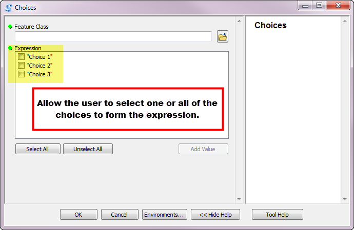

I want to allow the user who runs the script to select however many choices from a list to populate a field.

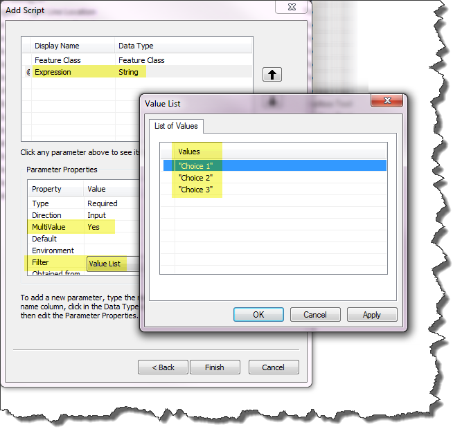

The choices are all string values I created in the script tool parameters using the Value List Filter for the Expression parameter.
For example:
    After using Add Field function, I need to populate/calculate the "Choices" attribute column.
     *The Choices field is not present before running the script. This is just to help visualize what I need.
The script window.

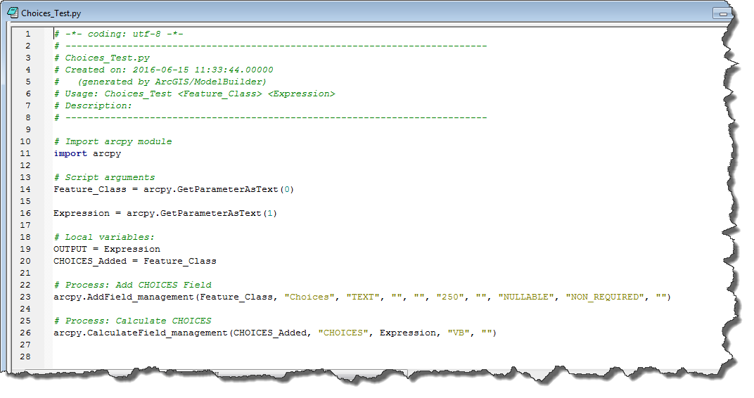

The following is the code for this script.
*This was extracted from Model Builder.

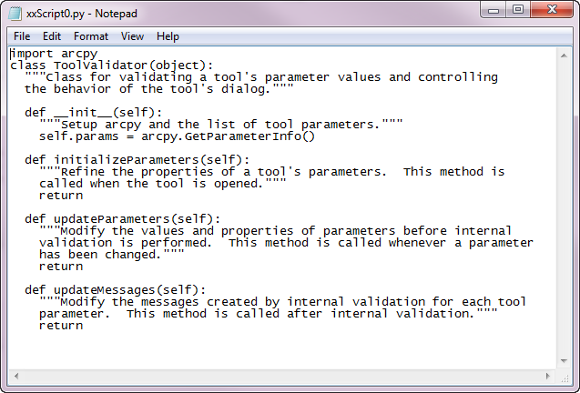

The following is the validation code for the script (which is the standard for a new script).
The following shows the parameters for the script.

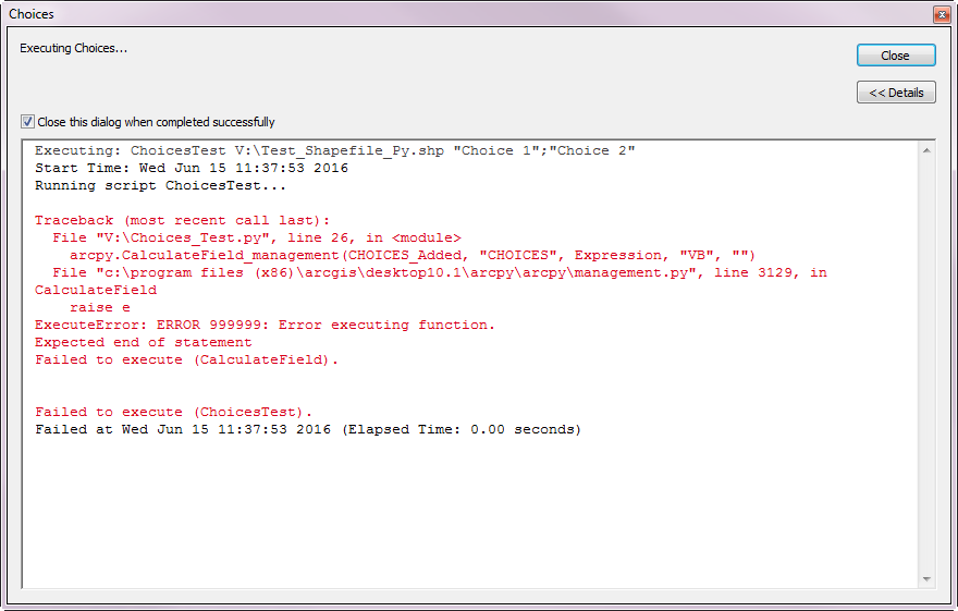

The following is the error message I get when running the script.
I am new to Python and could use some guidance.

My ToolValidation Code:
import arcpy
class ToolValidator(object):
   """Class for validating a tool's parameter values and controlling the behavior of the tool's dialog."""
   def __init__(self):
      """Setup arcpy and the list of tool parameters."""
      self.params = arcpy.GetParameterInfo()
   def initializeParameters(self):
      """Refine the properties of a tool's parameters. This method is called when the tool is opened."""
      self.params[5].filter.list = ["Gravity", "Gravity Gradiometry", "Magnetics", "Bathymetry", "Elevation", "Seismic", "Satellite       Gravity", "Satellite Magnetics", "Satellite Bathymetry", "Satellite Topography", "N/A"]
      self.params[5].value = "Gravity"
      return
   def updateParameters(self):
      """Modify the values and properties of parameters before internal validation is performed. This method is called       whenever a parameter has been changed."""
      if self.params[5].value == "Gravity" or self.params[5].value == "Gravity Gradiometry" or self.params[5].value ==       "Magnetics" or self.params[5].value == "Bathymetry" or self.params[5].value == "Elevation" or self.params[5].value ==       "Seismic" or self.params[5].value == "Satellite Gravity" or self.params[5].value == "Satellite Magnetics" or       self.params[5].value == "Satellite Bathymetry" or self.params[5].value == "Satellite Topography" or self.params[5].value       == "N/A":
      self.params[5].value = True
      return
   def updateMessages(self):
      """Modify the messages created by internal validation for each tool parameter. This method is called after internal       validation."""
      return
