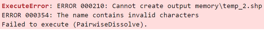

Hello,
The following code produces an the following error:
fc_mem_1 = r"memory\temp_1"
fc_mem_2 = r"memory\temp_2" # memory fails, use in_memory
arcpy.analysis.PairwiseDissolve(fc_mem_1, fc_mem_2, 'cl_id', statistics_fields=stat_fields, multi_part='MULTI_PART')
While the following code does not produce an error:
fc_mem_2 = r"in_memory\temp_2"
I understand in_memory to be a legacy workspace.  Is this expected behavior with PairwiseDissolve and Dissolve?

I just ran into the same with with arcpy.analysis.Union().  The out_feature_class will not accept memory\ but will accept the legacy in_memory.

Well, you definitely cannot have file extensions when you're using the memory workspace(s). And more generally speaking, I have found it pretty difficult to manage arcpy memory datasets unless they're being consumed almost immediately. In addition, there are certain spatial GP - Dissolve included - with which I never use memory. The need for an index (or something) means the tool doesn't usually work right.
