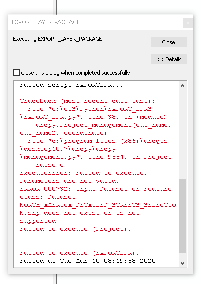

Thanks for your help once I fixed my inputs the tool ran but now I am getting this error, even though the output does exist and I'm not sure why it would not be supported.
JoshuaBixby
MVP Esteemed Contributor
When errors relate to parameters, it is helpful to share the actual values stored in the variables being passed to the tool (and workspace if you are relying on relative paths).  I am guessing the issue is will out_name, but I am not sure since I don't know what string is in the variable.
CarolineBanville
You are correct I'm having trouble with the paths, it seems to be defaulting to C:\Python27\ArcGIS10.7\ but the features are being created in my output workspace path.  I can't share my folder paths the data I'm working with is proprietary.  Right now the script is looking at a path where there is no output and I'm working on trying to re-path my variables so that out_name = Output_workspace + fc +"_SELECTION".  I'm having trouble with this because in the syntax for FeatureClassToFeatureClass includes Output_workspace so when I try to define out_name I get the path duplicated (i.e. C:\Data\Selection.shp\C:\Data\Selection.shp)
JoshuaBixby
It might be worth searching out some blog posts or tutorials on using file paths in Python since you are struggling with it.  In the short term, you can try saving the Result object from Feature Class to Feature Class and passing that to project instead of trying to reconstruct the path yourself:
res = arcpy.FeatureClassToFeatureClass_conversion(out_layer, out_folder_path, out_name)
arcpy.Project_management(res, Coordinate, out_name2)
CarolineBanville
This did the trick.  Thank you. I will definitely look into using file paths.
