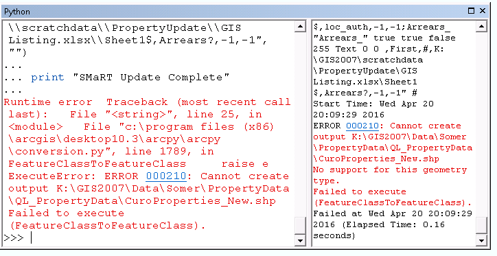

I am new at a company and I'm investigating a problem with a python script we have. The script basically extracts 1000s of rows of property data from a database (QL) and by using X Y data stored in this database, it creates a shapefile which we then use throughout the company.
The script was authored by a python expert who doesn't work here anymore. The script worked fine for him, and all the software was on 10.0 at the time. After an upgrade to 10.3 and 10.4, the script doesn't work for us now and throws up an ERROR 000210: Cannot create output K:\ blah blah..   Failed to execute (FeatureClassToFeatureClass). As I'm not that experienced with python scripting and the author of the script isn't around to help, I thought I'd ask here.
Here is the original code that has returned an error, only after upgrading our software from 10.0.

And this is the error:
We can't experiment and run modified scripts until the evening when no one is working in the office and using the data. So in the meantime, I'd love some of your expert tips!

Digesting that output could be assisted by looking for keywords that aren't allowed in sql queries, that error message is associated with it and the inability to create an output.  If the script worked in the past and doesn't work now, then trackdown internally what the difference in inputs or outputs might have been between runs.

thanks for the tips Dan. We actually managed to run the script today and although the error still appeared, the data still popped up in our ArcMap session. As an XY layer, not a shapefile. So we simply right click the layer, Data>Export Data... choose shapefile. And we have what we were after.
