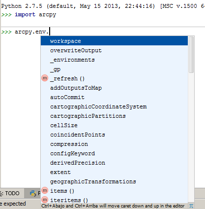

Can you give a specific example?
OskarKarlsson1
Deactivated User
Absolutely, for example when typing arcpy.env. I can see different options if I am in the editor or in the interpreter windows, within the saem IDE software, in this case PyCharm
Editor
Interpreter window
Thanks
JoshuaBixby
MVP Esteemed Contributor
I can give a partial answer now.  I have to check a couple of things before giving the other part of my answer.
Some of the difference is due to the interactive Python console hiding Python's dunder/magic/special methods from the user.  Python special methods are used for managing namespaces and implementing Python's approach to operator overloading.  Since the are "special," it is assumed the end user doesn't need to be interacting directly with them, so the interactive console doesn't list them.
Note, what you see in the PyCharm interactive console differs from what you see in the ArcGIS Desktop interactive console.  The PyCharm interactive console will show more of the special methods than the ArcGIS Desktop interactive console.
OskarKarlsson1
Deactivated User
I see your point, but what its "hidden" doesnt seem special to me, maybe even the contrary, as for example arcpy.env.workspace is basic in any arcpy script, and its not shown. More than that, seems that the geoprocesses are the ones not showing.
JoshuaBixby
arcpy.env.workspace is not a Python special method, it is an ArcPy environment setting exposed as a property on ArcPy's env class.  When ArcPy is instantiated, the environment settings get defined and stored as a set in one of the environment object's internal or private attributes, _environments to be specific.  You can use the Python dir() built-in function to see those environment settings, but you also see lots of other class attributes as well.  The following code snippet shows only the environment settings:
import arcpy
for env in arcpy.env._environments:
    print env
The interactive console is retrieving those environment settings and making them available for code completion to the user.  The set of environment settings doesn't exist until an instance of ArcPy is created, so a user doesn't see them for code completion in the editor window.
I can't say I am doing complete justice with this explanation, but I find it hard to get much more in depth without getting into the weeds of Python class structure and how properties are defined and managed.
I think Esri would argue one should use the online documentation to understand ArcPy and not rely on code completion in a code editor or interactive window.  Is Esri's implementation of the ArcPy Env class frustrating because of how it impacts code completion in editor windows, I think so; but I also think this factor is low on the list when considering how to structure ArcPy.
