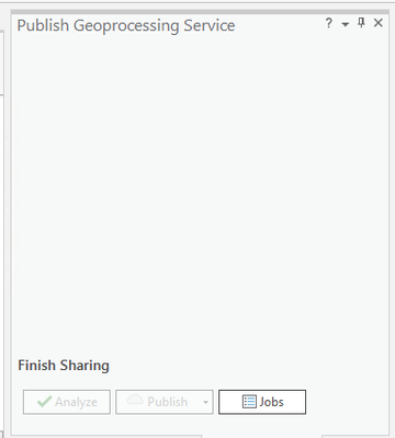

With GPFeatureLayer as outpt datatype my ArcGIS Pro adds the local processing result as a new layer.
But for some reason that I don't know (are there logs, console, anything???) I'm not able to publish my tool to the server. ANLYZE and PUBLISH buttons are disabled without any hint whats wrong. Again my tool runs successfully in ArcGIS Pro. Pls Esri help the developer a little bit.
RichardReinicke
Publishing worked after restart of ArcGIS Pro.
