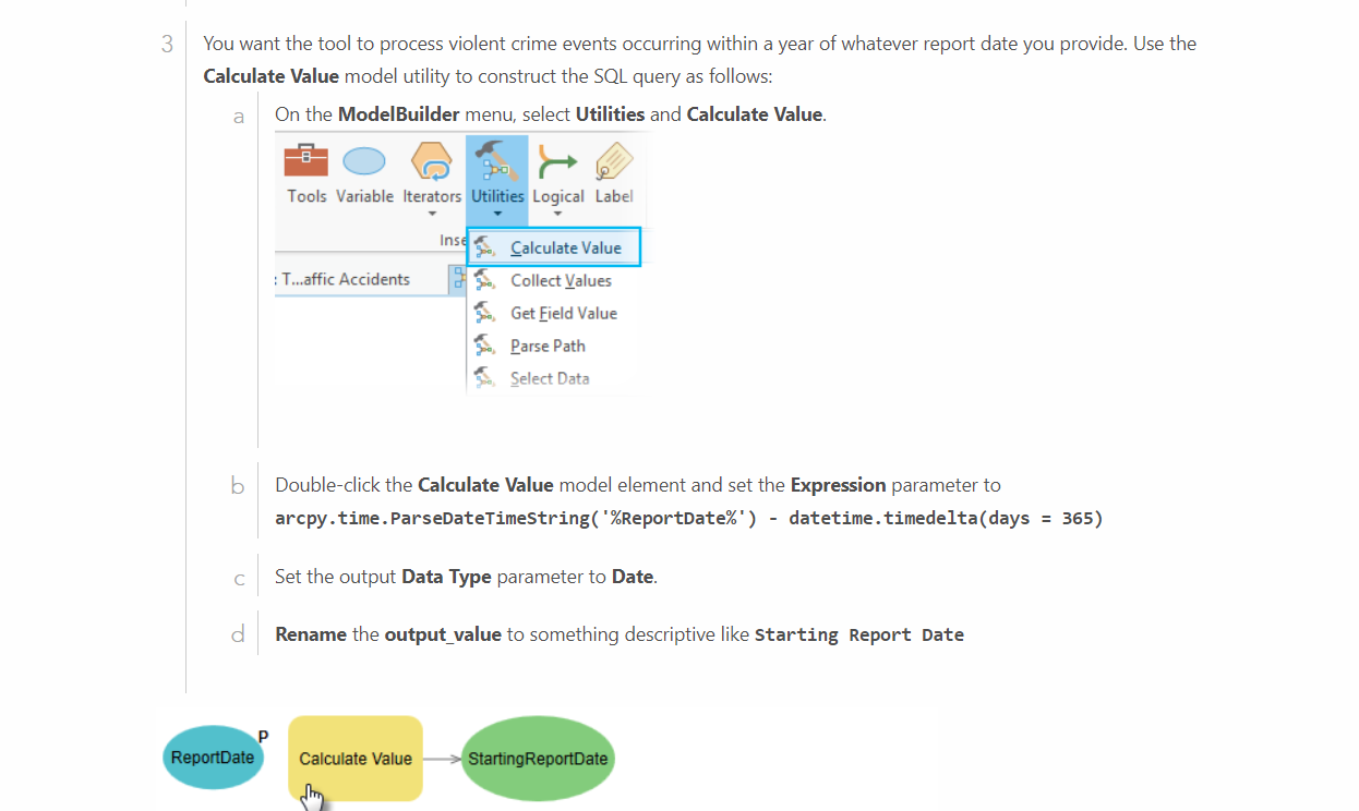

I am trying to follow this guide: Analyzing violent crime automation—Analytics | Documentation (arcgis.com)
I've followed it successfully, using my own data and I am at the stage of building the model.
I first created a varialbe for the report data which will be used to select any date, i've made it a peramter and named it Date (the first oval), i have then added calculate value and attempted to add the following expression:
arcpy.time.ParseDateTimeString('%ReportDate%') - datetime.timedelta(days = 365)

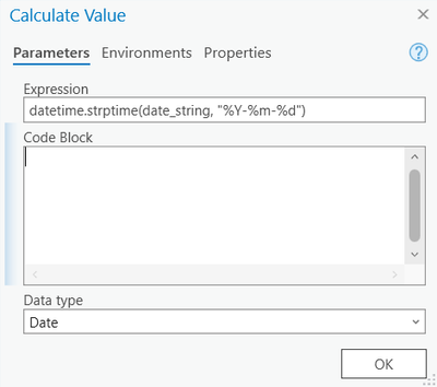

Looks like that expression starts to parse a date string for an attribute in your dataset.  There are ways to parse a string to a datetime, such as using the strptime() method, which is a built-in method of the datetime class.  Try something like this:
datetime.strptime(date_string, format)

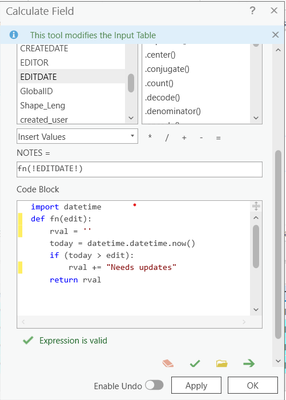

Just a style comment for you -- I usually use a separate code block, like this,
(I have no idea if the date compare "today > edit" would work - this is just to show the code block.)
That way I can test the code in a separate notebook, I can have import statements at the top, and I can spread the code out over several lines so it's easier to read and understand.
