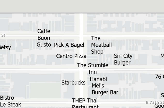

After running this code in a script tool, the labelling properties seem to reflect the changes.
However the rotation does not get applied in the rendering of the labels, however it works when I@@ do it manually.

Solved: Need to add this line of code in.
lblclass.maplexLabelPlacementProperties.rotationProperties.enable = True
