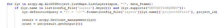

Here is where I read the layers in from the .APRX and query the ID fields.
    for lyr in arcpy.mp.ArcGISProject.listMaps.ListLayers(aprx, "*", data_frame):
        if (lyr.name in list(config_file['layers'].keys())) and (lyr.supports("DEFINITIONQUERY")):
            lyr.definitionQuery = "{} = '{}'".format(config_file['layers'][lyr.name]['projectIDField'], project_id)

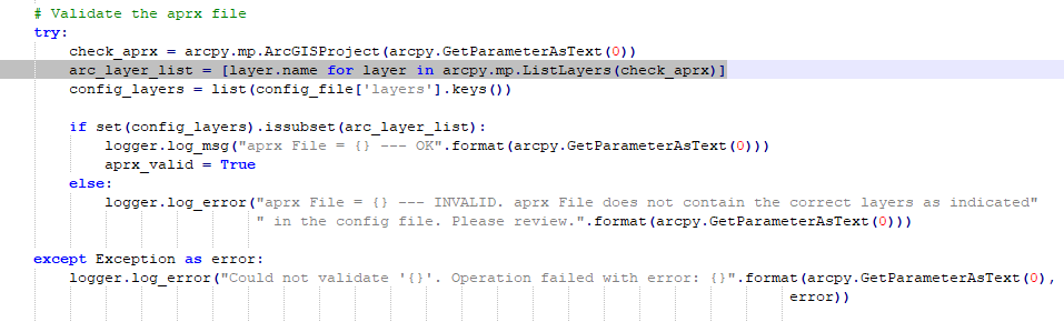

Here is where I validate the .APRX by checking the current layers against the config file.
   # Validate the aprx file
    try:
        check_aprx = arcpy.mp.ArcGISProject(arcpy.GetParameterAsText(0))
        arc_layer_list = [layer.name for layer in arcpy.mp.ListLayers(check_aprx)]
        config_layers = list(config_file['layers'].keys())
        if set(config_layers).issubset(arc_layer_list):
            logger.log_msg("aprx File = {} --- OK".format(arcpy.GetParameterAsText(0)))
            aprx_valid = True
        else:
            logger.log_error("aprx File = {} --- INVALID. aprx File does not contain the correct layers as indicated"
                             " in the config file. Please review.".format(arcpy.GetParameterAsText(0)))

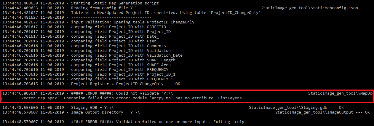

Here is the output/ERROR:

Sorry for the late reply but your response wasn't helpful at all. I thought it was clear from the screenshots that I was using arcpy.mp but regardless, for those experiencing this issue the problem is you need to stipulate each method call separately.
So something like:
Should be:
mapView = aprx.listMaps()[0]
for layer in mapView.listLayers():
 if (layer.name in list(config_file['layers'].keys())) and (layer.supports("DEFINITIONQUERY")):
 layer.definitionQuery = "{} = '{}'".format(config_file['layers'][layer.name]['projectIDField'], project_id)
