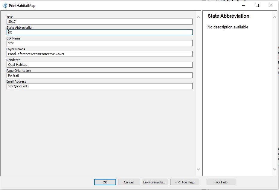

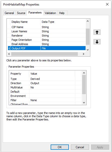

How the output parameter is set (there are 8 parameters, I just can't expand the window to show them all):
Input window (don't mind the x's):
