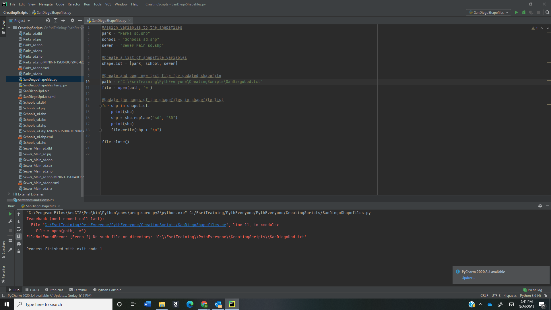

Hi.  I saw an older post about this exact same problem, though the solution offered (an error in the path) does not seem to be the problem, or at least I can't see what is the problem after over an hour on this specific part of Exercise 3 in the 'Python for Everyone' course.  Here is my screenshot from PyCharm showing my code and the error message:

and here is the error message at the bottom:
"C:\Program Files\ArcGIS\Pro\bin\Python\envs\arcgispro-py3\python.exe" C:/EsriTraining/PythEveryone/PythEveryone/CreatingScripts/SanDiegoShapefiles.py
File "C:/EsriTraining/PythEveryone/PythEveryone/CreatingScripts/SanDiegoShapefiles.py", line 11, in <module>
file = open(path, 'w')
FileNotFoundError: [Errno 2] No such file or directory: 'C:\\EsriTraining\\PythEveryone\\CreatingScripts\\SanDiegoUpd.txt'
Process finished with exit code 1
I think my problem (based on my error message, and the older post about this) is the path.  The ESRI module says it should say:
path = r"C:\EsriTraining\PythEveryone\CreatingScripts\SanDiegoUpd.txt"
When I went into my File explorer and checked to see if the Path was valid, is seemed to be, though there was no SanDiegoUpd text file there (I assume because the script failed and didn't create this file).  There was an empty such text file in the "Solutions" folder (instead of in "Creating Scripts" folder) so I later copied and pasted that into CreatingScripts, thinking that perhaps the text file had to exist to start with, but same result of error message above.  Not sure what I am doing wrong??

Luke_Pinner
MVP Regular Contributor
Looks like the folder r"C:\EsriTraining\PythEveryone\CreatingScripts" doesn't exist.
Based on the bit of your error message that shows the name of your script, it should be r"C:\EsriTraining\PythEveryone\PythEveryone\CreatingScripts\SanDiegoUpd.txt"
Note the "PythEveryone\PythEveryone"

SarahBlake
Thanks so much! That was it.  Silly mistake of mine, not to notice my extra "PythEveryone" folder...
Just tried it again and it worked!
