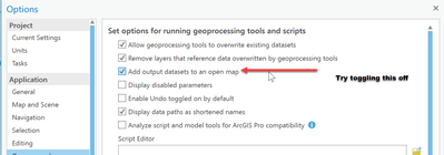

DanPatterson
MVP Esteemed Contributor
Always on for me, try toggling it off
... sort of retired...

DanPatterson
davedoesgis
I didn't try this, since I was looking for a solution in Python, but it seems like this would also do the trick using the GUI. The only issue with this I suppose is that you can't toggle it on/off/on/off during a script's execution.
