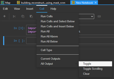

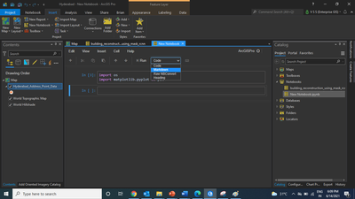

1. In Run do it Markdown as mention in below pic.
2. All Output to be toggle.
