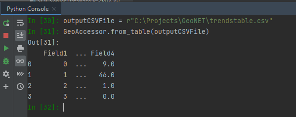

Also here is a screenshot of the CSV. I think something is happening with how pandas is creating the CSV. When trying to read the CSV file, it is not being read correctly. See below:
I'm wondering if it has something to do with the delimiter being used or something else?

Hey, my initial guess from the key error is there's a missing column header. I noticed you are exporting to csv without taking out the index column. Can you try changing this line
trendstable.to_csv(outputCSVFile, sep='\t', encoding='utf-8')
to
trendstable.to_csv(outputCSVFile, sep='\t', encoding='utf-8', index=False)
FredMitchell
Hi @EarlMedina,
Thanks so much for your reply! I noticed this earlier today and thought that might be an issue as well and so I tried it with index=False and with header=False. I also tried not defining the separator. When I open the csv in excel all the data is there. However, when I open it in ArcGIS Pro some of the fields show all the rows as Null. I wonder if this might have something to do with why it's not working. Same thing happens when I try loading it into the GeoAccessor. I recently tried re-working my code to push the dataframe to an XLS instead of a CSV and then to a table. This seems to be working but I'm still not sure why the CSV is loading with null values. I'll post my code with the XLS work around if I can get it to fully work.
