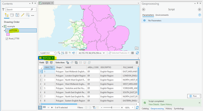

Could not find an easy way to do this within arcpy.mp, however using a SendKeys style hack off of Stack Overflow you can send the Keyboard shortcut Ctrl+T right after adding the layer. See the code below, if you paste this directly into the Python window it doesn't work because it sends the keystrokes to the code editor, however if you put the script behind a Geoprocessing tool, it does work for me ..

RHmapping
