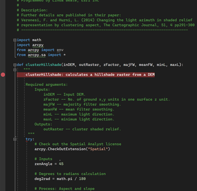

So I went into VSCode and looked for anything strikingly obvious, and everything looks decent. There were no errors, and the indents were consistent from my general python knowledge:
And here is the code sample in its entirety (it's not overly long).

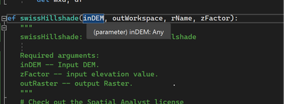

So at the bottom theres the *args that is looking for parameters from clusterHillshade, and I suspect something is going on with the inDEM parameter but that's as far as I can take it. The main hangup appears to be something where "inDEM" is not accessed whereas "inDEM" isn't greyed out for a different script.

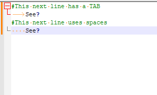

The error is pretty straightforward, it looks like. (And I get bitten by it all the time in the Python Window).
Python relies on indentation to determine loops, etc.
You can use either tabs or spaces. A tab frequently looks like the same space as 4 or 8 spaces depending on the program you're using, but is considered to be an entirely different length.
To fix it, open up the script in a text editor (I like Notepad++) and make sure that you can view whitespace chars. Find and replace all the tabs with spaces.
As an aside, many text editors will just turn tab key presses into spaces to avoid this problem. That, or if you have a tab, tabbing the line will turn it into spaces.
