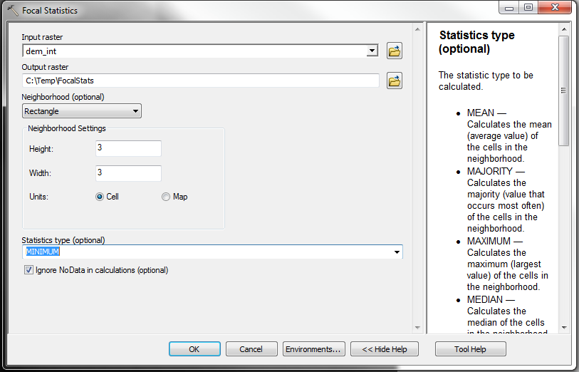

Then, why not just run a raster filter for Min on the original raster with a 3X3 processing window?
RachelAlbritton
The route makes a lot more sense. I ran the tool, but the output was exactly the same as the input. I find that odd, don't you?
NeilAyres
MVP Alum
You ran this tool on your data...
This is in SA Tools / Neighbourhood /
The result cannot be the same...

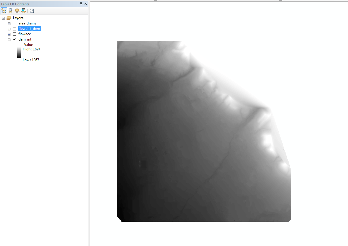

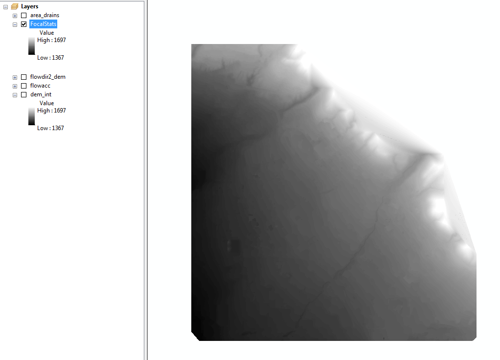

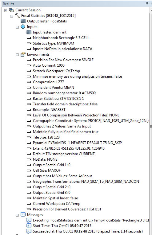

RachelAlbritton
That's exactly what I ran and the results came out exactly like my DEM - somethings wrong and I'm not sure what. DEM being used as input (notes high and low values):
Focal Stats Window:
Results (Note image and high/low values are exactly the same as the DEM)
NeilAyres
MVP Alum
Just because the min/max values in the TOC are the same, the internal values (ie the distribution) should / have to be a bit different.
