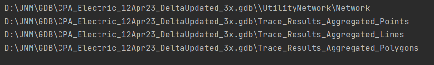

I am running the arcgis pro utility network Trace tool in pycharm and storing the results in a variable but from that variable i am not getting the traced features, any suggestions how will i get the traced features.
import arcpy
gdb = "some_gdb"
arcpy.env.workspace = gdb
fds = arcpy.ListDatasets("*", "Feature")
results = arcpy.un.Trace()
for i in results:
print(i)
I am getting results like this any suggestions how will i get the traced features.

The results are the paths to the feature classes. You can use the arcpy.da.SearchCursor() to iterate through any of the result feature classes to access the attribute table information.
https://pro.arcgis.com/en/pro-app/latest/arcpy/data-access/searchcursor-class.htm
