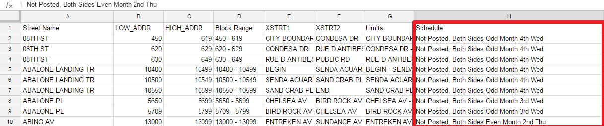

What are good python code samples/libraries that I could use to parse the Natural Language Parsing of Recurring dates that are in string value (eg. Not Posted, Both Sides Even Month 2nd Thu) into quantified values such as a calendar date (example: "16/04/2015")?
Objective:
I want to parse a data field in a street sweeping schedule data table.  The data field contains recurring dates in the natural language: eg. "Not Posted, Both Sides Even Month 2nd Thu" into a numerical data format for further processing in the Field Calculator.
The output field that I want to create will tell me the "x number of days since street was last swept".

ShaunWalbridge
Do the spreadsheets contain additional date related information? In your example, how did you determine the month and the year? I don't see that data encoded anywhere in the columns listed. I'm also not sure you really need any actual NLP software to do this analysis, you're probably better off starting with a robust date parser, like say bear/parsedatetime · GitHub or https://labix.org/python-dateutil, and using that to generate the dates. You'd still need more information than what's in the spreadsheet, since it doesn't include information about the year, but should help with figuring out the relative date given the year and month.

Re: the spreadsheet.  The spreadsheet only contains the recurring date information as posted on the street signs. Re: the date to compare the recurring data from -- that date will come from another data source: the satellite image date of capture.  eg. "Landsat 8 date 18Mar2015.tiff"
The function will have two parameters: (satellite image date-stamp, street sweeping recurring schedule string). The parameters will come together in a storm drain feature class that I created to model the connection between the two variables.  The storm drain data table will have a "water quality data field" and the "recurring street sweeping schedule" data field.  (optional) for details on the ArcMap model see: report in pdf.
