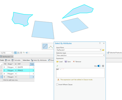

Edited moments later: are you really using a shape file, because they don't support <Null> values....

I created a shapefile just to try what you are doing I get really weird results in a SQL select window.  I bet I haven't created a shapefile in over 10 years, and this is one of the reasons why:
