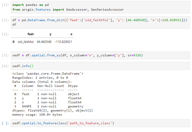

Hi @ColeHowell,
Lots of ways to go about this.  Here is one option which stays within Python using the Pandas and the Geoaccessor Namespace.
1) ETL your desired points and point attributes into a Pandas DataFrame.  Below is an example with one hard coded point (Old Faithful).  Ideally, you will not be hard coding your points, rather ETL'ing them from your source.  Pandas can load from many sources.
2) Convert the DataFrame to a Spatially Enabled DataFrame using the GeoAccessor Namespace.  Notice the new SHAPE column and Dtype of 'geometry'.
3) Write to a gdb.
HTH.
