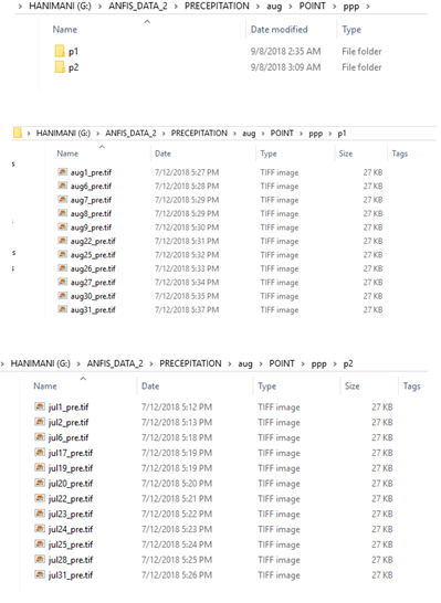

I am trying to make a loop function.  loop function picks up the rasters file from every subfolder, composite(layer stack#) the raster file and keeps it in that subfolders. I am getting an error. please help anyone. Under ppp folder have two subfolder P1 and P2 both folders contain the raster file. Thanks in advance.

My aim is, the code will go to every sub-folder ( P1, P2,...) under ppp folder after that code picked up the raster files individual folder and will do band composite and saved this composite file by unique name in the same folder(P1,P2,...).
PPP
   P1 -Raster files picked up--- Band composite---save in P1 folder by unique name.
   P2 -Raster files picked up--- Band composite---save in P2 folder by unique name.
   P-Raster files picked up--- Band composite---save in Pfolder by unique name.
