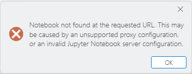

I am getting the following error when trying to open a new or existing notebook.
I can access the notebooks via VS Code but not in ArcGIS pro.
I am running version 3.2.1
does anyone know a fix?

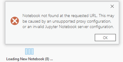

I'm having the same issue, running 3.2.0. Just started today afaik...

I was working with esri support for about a week on this issue.
We could not figure out the underlying issue causing it, but it was localized to one user.
If you open a different user on you computer and try to run notebooks in arcgis pro it should work.
I just ended up migrating all my stuff to a new user.

It turns out that in my case, I had a python installation outside of Arc Pro that was more recent, and that seems to have been the source of my problem. Once I removed the other install, Notebooks would open in Arc Pro as before.

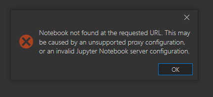

Hello, I'm facing the same issue, after updating to Arcgis Pro 3.4.0, any suggestions on how to solve that?

Experienced the same issue. Curious to me was that I successfully opened and worked from a notebook within ArcGIS Pro one day, and could not re-open it the next. That second day, I was able to successfully open and work from a new notebook, but again could not work from it the following day. On that third day, I was not able to get a single notebook working.
My solution was to clone the Python environment from within ArcGIS Pro and then initialize the environment from a Jupyter notebook using VSCode. For me, this solved everything. If you don't specifically need the visual map in ArcGIS Pro but are just trying to query/interact with data living in your ArcGIS Organization/account, I highly recommend this approach. For those needing some basic mapping, there are plenty of libraries available to choose from - this is likely much better than waiting for this issue to be solved!
