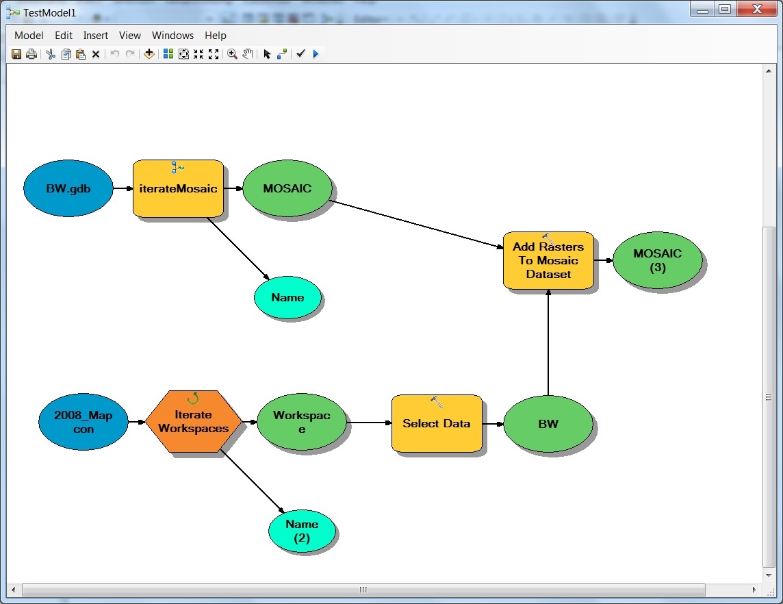

My raster mosaic datasets are in a file gdb ordered by block. For example Block_470 and Block_480.
My workspace has images ordered by block with subfolders with in each block. For example workspace Block_470 contains subfolders BW and RGB. This is the same for workspace Block_480. Meaning workspace Block_480 will also have subfolders BW and RGB.
I need to add the tiff files in workspace Block_470/BW to raster mosaic dataset Block_470 and the tiff files in workspace Block_480/BW will need to be added to raster mosaic dataset Block_480.
How can I iterate through so that the right tiff files in the subfolders go into the corresponding mosaic datasets?
