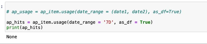

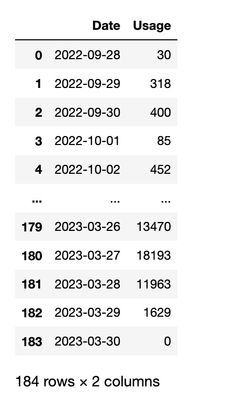

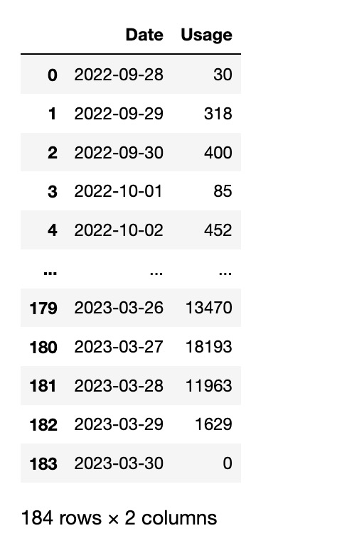

I want to be able to query the number of item requests during a certain time period. If I use:
ap_hits = ap_item.usage(date_range = '6M, as_df = True)

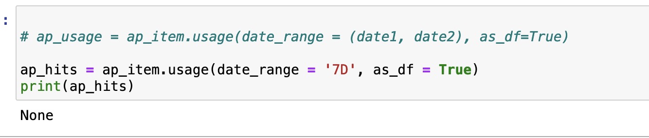

 But if I uses date_range = '24', '7D', '30D', or '60D' it comes up as None
As you can see from the '6M' option, I do have requests in the last 7D.  Why can't I do get the requests with specific time dates less than 6 months?

BUG-000155249 has been fixed. Can confirm that returning as data frame now works expected
from arcgis.gis import GIS
gis = GIS("home")
# Replace 'item_id' with the actual ID of the item you want to retrieve
item_id = ''
# Get the item by ID
item = gis.content.get(item_id)
item_hits = item.usage(date_range= '7D', as_df = True)
print(item_hits)

You can get the usage if you don't return it as a data frame:
testDictionary = item.usage(date_range='30D',as_df=False)
 But then you have to combine them together. I made a spreadsheet from the dict. Another user sums it, example here:
