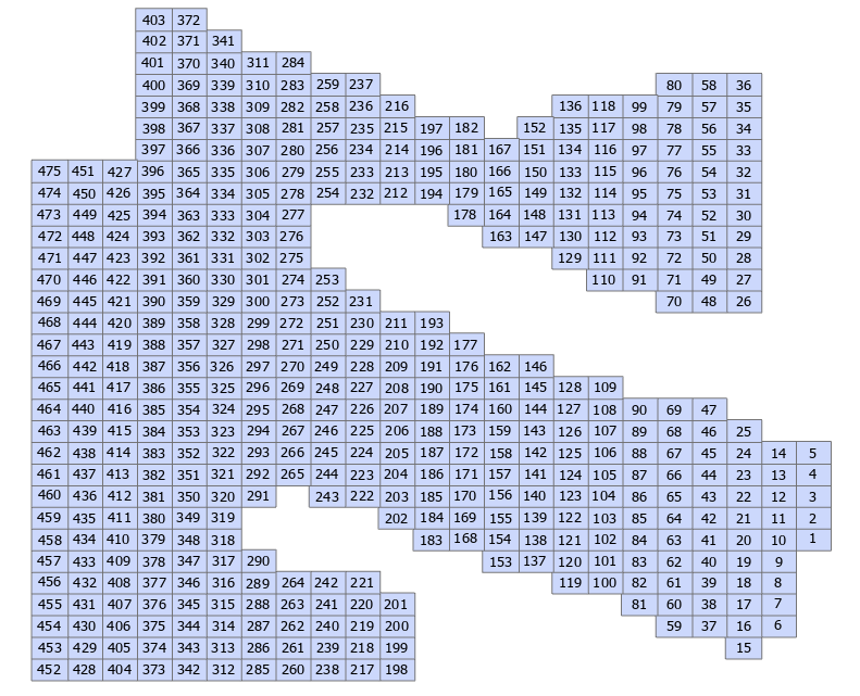

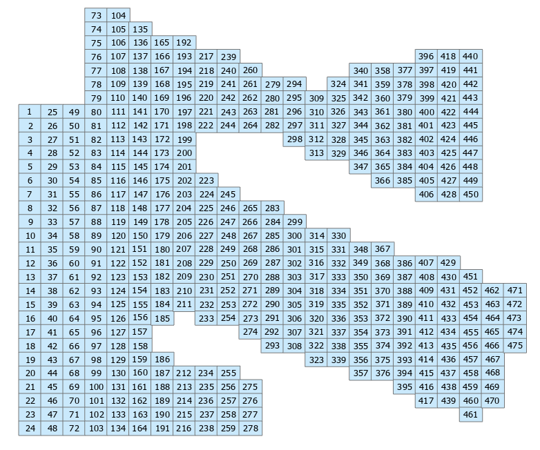

 The problem is that the two-part lambda sort does not always work. If the FIRST sorting is along the x-axis (EW/WE), it will. The first image is east to west, then south to north. The second is west to east, then north to south. Both are created as expected.East to West, then South to North.East to West, then South to North.West to East, then North to South.West to East, then North to South.
The problem occurs when x-axis sorting is done as a SECONDARY priority. Here is an example using inputs "SN" and "WE" as inputs, for south to north followed by west to east. The primary sort, south to north, works fine. However, the west to east does not, and the ordering appears arbitrary.
