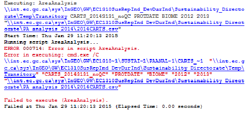

I create an ArcToolBox with python on ArcMap 10.1 (Arctoolboc/Add Toolbox after add Script ....). This toolBox work very fine on my PC.
I shere this tollbox with another collegue and i shw him whow to add it and work with it. The problem that as soon as he run it, he got the following message:
I don't understand the cmd.exe/c error. I looked on the web and on arcgis hepl, I still not understant it
Any hepl please????
Thanks

Is it trying to run a file off a local drive?  In this case you would need to place the file in the right local folder on the colleague's computer or update the file location in the tool.  Otherwise, are you certain you set up the script properly and the second computer?  The script file needs to be in the proper location and the tool needs to be referencing the proper script file location.  Hope this helps.
ChrisPedrezuela
Probably best to share your tool and scripts related to it so to better diagnose the problem.
OwenEarley
The error message (000714) indicates a problem with the script. By the elapsed time of 0.00 seconds it looks like your script did not get to any processing steps - this indicates the problem is most likely in the parameter values.
Are there any drive mapping differences between the two machines (including file permissions)?
It may be helpful to post the core parts of the script.
SaidAkif
Thanks guys
Indeed, it was a parameter value issue
Now it work fine
