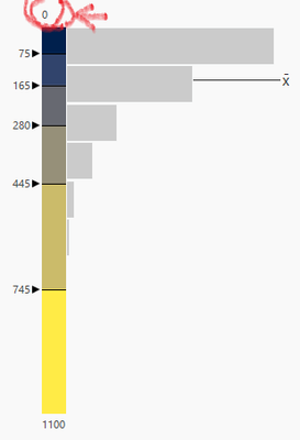

The image is from the "Use symbology histograms" page. How can I rewrite the value in the red circle with Arcpy?

From my experience, you cannot change the minimum value by arcpy. Neither are the other values of the histogram. If your aim is automation, you need a strategy for the output at least similar and you can apply the symbology using symbology tools or symbology parameters in the Script tool.

Thanks for the reply.
In ArcMap, by rewriting the classBreakValues property of the GraduatedSymbolsSymbology class with a list, it was possible to make the first number the minimum value.
When using Apply Synbology From Layer, if there are features that are less than the minimum value of the original layer, they will not be displayed.
I was using a script that rewrites the minimum value to -1000000000 and the maximum value to 1000000000 so that it can be applied to a general range.
I would like to create a similar script in ArcGIS PRO.
Do you have any ideas for alternatives?

The current script follows the ClassBreak documentation for GraduatedColorsRenderer. (Very similar to the document you provided)
https://pro.arcgis.com/ja/pro-app/latest/arcpy/mapping/graduatedcolorsrenderer-class.htm
https://pro.arcgis.com/ja/pro-app/latest/arcpy/mapping/classbreak-class.htm
The upperBound property can only be rewritten to the upper limit of the range. Therefore, in the range "0-10", if ClassBreak.upperBound is rewritten to "20", it becomes "0-20", so I am looking for a way to rewrite "0".
