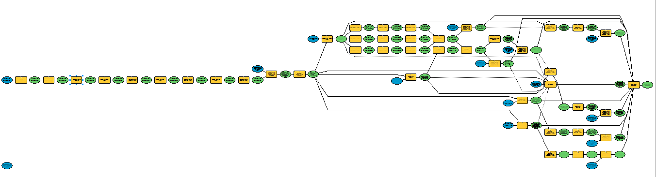

I have created Models in Model Builder. this basically does below things.
  1. Field Calculation to prepare relevant data.
  2. Spatial Join to compute Statistics.
  3. Applies Spatial filters.
  4. Create Summary  data.
In all these steps It takes  around 4 hours.
Is it possible that If I write this same model in  Python and then execute, It will take less time to execute?
or is there any other way, through which I can improve the performance of this?
I have such 7 models.
Your help is appreciated.
Thanks
Ravindra Singh

I've had a look at your model. One thing that would have improved performance is to ensure all your datasets have spatial indices but as all your data were file geodatabase feature classes you are already doing this.
Nothing particularly leaped out at me as performance blocking steps which leads me to ask about your data. You do not actually say anything about it? Is it millions of polygons or just a few thousand that are horribly multi-part? In a part of your model you are selecting and sorting then sub-selecting multiple times, if you are doing this on a table with 10,000,000 rows then the time taken is not surprising.
Whilst Neil Ayres​ is a good route to go for improving performance you'll be taking your work out of the model builder environment which is something you may not want to do?
You need to give more information about your data and it's context.
