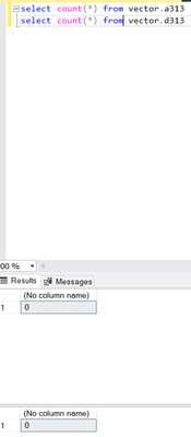

I would verify the feature classes' A&D tables are cleared after the compress.  If there is a lock on the feature class, the compress will skip over the feature class.  If your database is SQL Server you can find the correct A&D table with the following:
  • query the sde.sde_table_registry table to get the registration_id.  Ex:
select registration_id from dbo.SDE_table_registry where table_name = 'Airports'
This will return the registration_id:
This will indicate which A&D tables to query.  Ex:

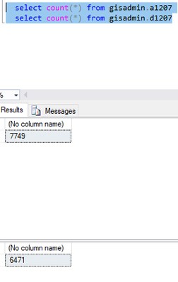

I'm glad you posted a follow up to this! It looks like it isn't being compressed as the a/d tables contain:
Which is possibly several years worth of changes!!!
Thank you! In the script that automates the compress it looked like it disconnected users and ran the compress but maybe it doesn't do this table, even though this table is in the same SDE its pointed to do a compress on.
I'd better do some deeper investigation...
