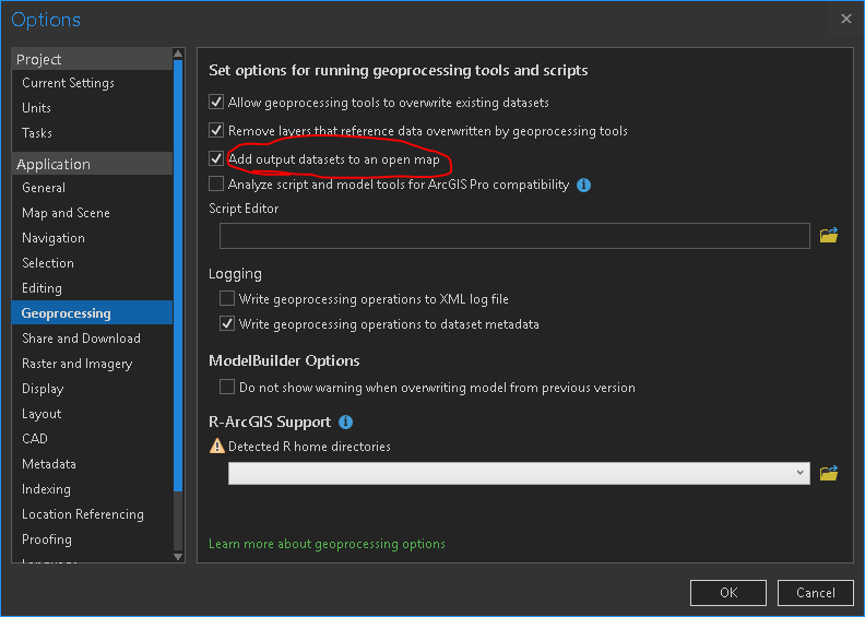

I have confirmed that my "Add output datasets to an open map" is enabled in my Geoprocesing Options.
